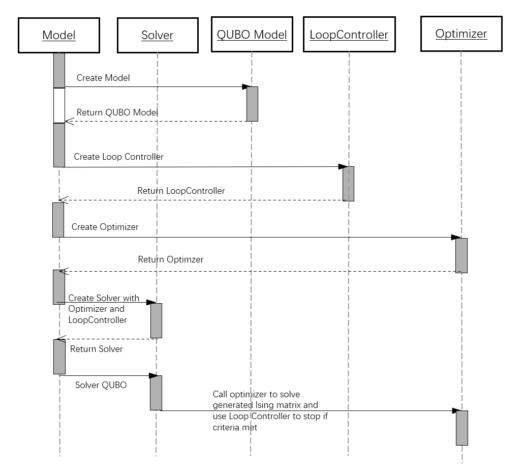

在典型应用中,用户先通过 core 或 hobo 进行问题建模,将模型转换为QUBO或Ising矩阵;随后使用 preprocess 对矩阵进行精度、位宽或范围适配;最后根据场景选择 classical 本地优化器、cim 真机优化器,或通过 hybrid 的惩罚项方法统一处理带约束问题。common 和 license 则贯穿整个流程,分别提供工程支撑和企业版授权能力。

        sequenceDiagram
   autonumber
   participant User as User code
   participant License as license
   participant Model as core / hobo
   participant Preprocess as preprocess
   participant Hybrid as hybrid
   participant Optimizer as classical / cim
   participant Result as sampler / common
   User->>License: init / ensure_license()
   License-->>User: license validation result
   User->>Model: Build Binary / Spin / HoboModel
   Model-->>User: QuboModel / IsingModel / matrix
   User->>Preprocess: Bit-width evaluation, precision adjustment, range adaptation
   Preprocess-->>User: Preprocessed QUBO / Ising matrix
   User->>Hybrid: PenaltyMethodOptimizer.solve()
   Hybrid->>Optimizer: Call optimizer.solve(matrix)
   Note over Optimizer: classical is used for local debugging and small-scale solving<br/>cim connects to the SPQC backend
   Optimizer-->>Hybrid: Candidate solutions / energy / runtime information
   Hybrid->>Result: Result evaluation, sorting, logs / checkpoint
   Result-->>User: Optimal solution, solution pool, and metrics
   Note over Model,Result: core / common are provided by kaiwu-community<br/>kaiwu provides cim, classical, hobo, hybrid, license, preprocess, sampler
