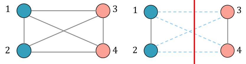

Taking a four-vertex example as shown in the figure below, we can observe that the “cut” method of dividing 1 and 2 into category A and 3 and 4 into category B obtains the optimal solution to the problem, Z=4Z=4.

When vertices 1 and 2 are in one group, and vertices 3 and 4 are in another group, s1=s2=1,s3=s4=−1s_1=s_2=1, s_3=s_4=-1. Then the above formula becomes
∑i<j,i∈V∑j∈Vwijsisj=w12−w13−w14−w23−w24+w34 \sum_{i<j,i \in V}\sum_{j \in V}w_{ij}s_is_j = w_{12}-w_{13}-w_{14}-w_{23}-w_{24}+w_{34}
At this time, the objective function is:
maxZ=(∑i<j,i∈V∑j∈Vwij−∑i<j,i∈V∑j∈Vwijsisj)/2=w13+w14+w23+w24=4 max Z = (\sum_{i<j,i \in V}\sum_{j \in V}w_{ij}-\sum_{i<j,i \in V}\sum_{j \in V}w_{ij}s_is_j)/2= w_{13}+w_{14}+w_{23}+w_{24} = 4
The maximum number of cuts is 4, which is consistent with the answer obtained through observation in the previous article.
