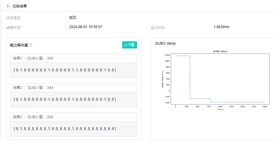

Using SPQC for calculations#
If you use the real machine to calculate, you need to use the following code to generate a csv file and upload it to the cloud platform
qubo_mat = qubo_model.get_matrix()
pd.DataFrame(qubo_mat).to_csv("tsp.csv", index=False, header=False)
Using the Bose quantum cloud platform to call a special-purpose quantum computer to solve the TSP problem, the results obtained are shown in the following figure. The shortest path value has been verified to be the same as the above method, with a time consumption of approximately 1.66ms.
The result 1 is the optimal solution. According to the previous variable definition, each group of 5 represents a node on the graph, each group of 5 variables represents 5 positions, and a value of 1 indicates that the first node passes through the corresponding position of the path.
